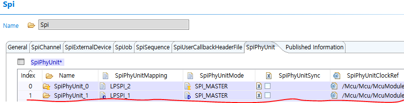

I have to use SPI 3 channels and I am using EB TRESOS.
- SPI 1 channel is activated well.(communicate with TLE9262)
- I have to add SPI 2 channels as master
I think that I have to add SPI physical unit as below.
But when I added SPI physical unit, MCU did not work at Trace32
- build was done.
- If I removed SPI physical unit, MCU worked.
How can I add 2 more SPI channel?

kimjunghyun
Hi.
MCAL package version : S32K14X_MCAL4_2_RTM_HF2_1_0_0
SPI, MCU configuration : refer to attached file
First I have to update as below
I changed MCU clock, SPI clock settings and then MCU worked at Trace32
Thank you
