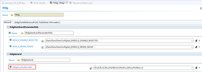

I have a question: in multi-core chips like the s32k324_mqfp172, it is possible to configure WdgEcucPartitionRef in the MCal configuration; however, for single-core chips like the s32k344, the MCal does not allow configuring WdgEcucPartitionRef. Why is this? What is the role of WdgEcucPartitionRef in actual code?
From my understanding: WdgEcucPartitionRef refers to which partition of the Ecuc module a specific module is assigned to; in reality, both single-core and multi-core chips require this EcucPartition. Is my understanding correct?"

The configuration interface for multi-core processors is shown as follow
