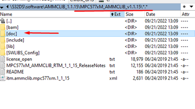

I am a beginner in Motor control. I am confused about how to use AMCLIB.
 Where can I find description about AMCLIB's function ?

petervlna

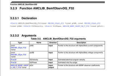

Documentaion to each moudule and functions are inside installed package:
In user guide you will find API description. For example:
