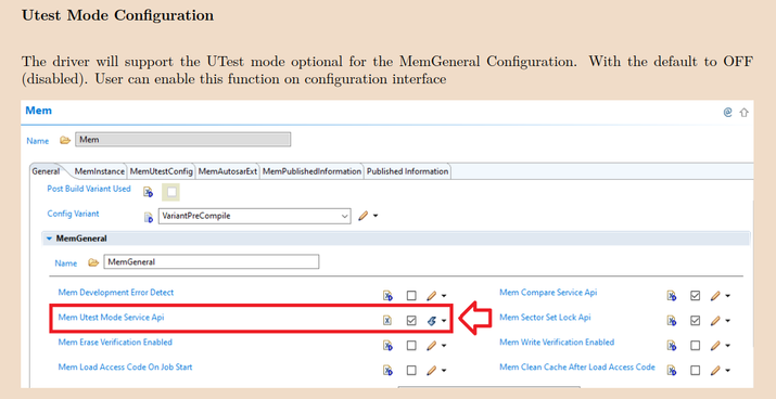

davidtosenovjan
UTEST sector definition is the same over all S32K3 family.
I would expect some sort of extra protection as UTEST is OTP memory.
Typically HSE FW is being installed by different method, for instance by debugger, but this options is possible as well, of course, but I haven't tested it until now.
1,747件の閲覧回数
MarkFan
Hi David,
    Thanks for your reply.

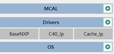

    I use SD3.5 with RTD 3.0 SDK
    There is no UTest driver as you show on the screen.
     How can I get this UTest driver?
Mark
1,740件の閲覧回数
davidtosenovjan
I see. Current version of RTD is 6.0.0. I would recommend to use current version.
