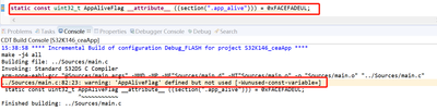

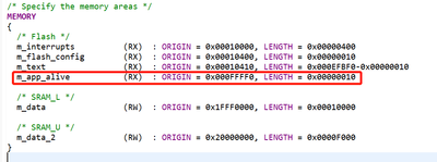

Hi, I need to place a const into Flash area. I do this project on S32K146 with S32DS ARM V2.2.
The following is what I do, failed.
After building, I can't find AppAliveFlag in MAP file.
Anybody can help me? Thanks!

Hi @fedotech,
I just tested it, it works without the static keyword,
BR, Daniel
