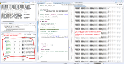

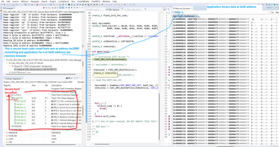

and at flash address: 0x00, i have dumpled hello world example. ( via external debugger tool Jlink Lite)
Now when i reset the device 2 times and Debug the code from RAM (via S32 Design Studio) i can see FCSESTAT register values in which secure boot is successfully done.

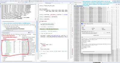

Now i change the application at address 0x00 of flash by dumping adc demo code via jlink flash tool, and then again debug the secure boot code from RAM via S32 Design Studio, i can see FCSESTAT register values in which secure boot is successfully not done.
But then when i change back the original hello world application at 0x00 address via jlink and debug the secure boot code again from RAM, it should show success secure boot bits in FCSESTAT register values. As now my original application is being booted at address 0x00.
Correct? Is this analogy and understanding correct!?
If yes, then in last step i get FCSESTAT register values of secure boot as not successfull( CMAC doesnt matches). Why is it so??? Technically and logically it should pass...
Let me know if you are able to get my flow and query, otherwise will send this flow with pics.!

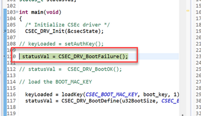

lukaszadrapa
Hi @kual_gettobyte
I think it's because you are calling CSEC_DRV_BootFailure like this in your RAM application:
You are not supposed to to that in this way.
If you are NOT creating chain of trust, the procedure should be:
1. Check if secure boot was successful (BOK == 1).
2. If it was successful, run CSEC_DRV_BootOK to finish the secure boot. If it failed, run CSEC_DRV_BootFailure.
If you are creating chain of trust:
2. If it failed, run CSEC_DRV_BootFailure. Do not proceed to next steps.
3. If it was successful, verify MAC over your application.
4. If it is OK, run CSEC_DRV_BootOK to finish the secure boot. If it failed, run CSEC_DRV_BootFailure.
In other words, I guess that the secure boot was successful but you cleared the BOK  flag by running CSEC_DRV_BootFailure.
Lukas
