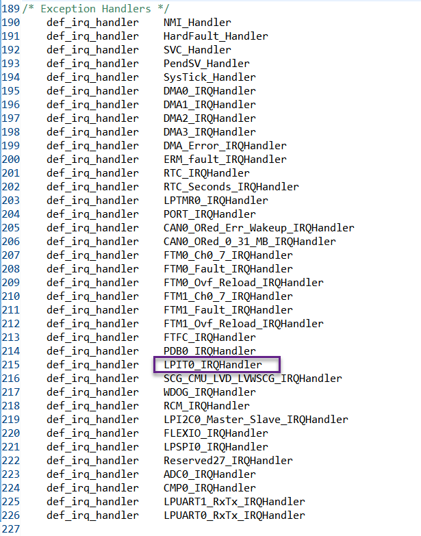

How to get the interrupt  function name about the LPIT0 in the S32K116?  for example  the can interrupt name is "CAN0_ORed_0_31_MB_IRQHandler",the LPTMR0 interrupt name is "LPTMR0_IRQHandler",what does it accord to which the names is geted ?

You can find the handlers in the startup_S32K116.S file

thank you very much,I get it!
