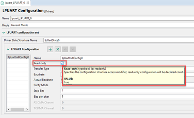

I want to generate configuration structures used by SDK as "const"
All the structures generated by SDK config tool are "not const" and therefore, put in RAM. We wonder if there's a way to generate them as "const"
 Is it possible to do that or not ?
I am using S32K142 EVB and s32kDS3.4
3,713 Views
lukaszadrapa
I'm afraid the answer is no. This is hardcoded, there's no such configuration.

lukaszadrapa
Hi Rehab,
it's possible only if you can see such option directly in the configuration tool. For example:
Lukas
