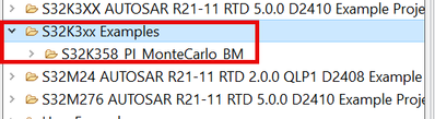

I am a newbie to understand NXP environment for developing some of the projects. I wonder I added some packages on IDE. I can't see normal S32K1xx examples like S32K3xx Examples.
How can reach to them?
Kind Regards,
1,396 Views
IsaulO
Hi @batuhanarslan ,
This S32K3xx Examples folder comes with the S32K3xx Development Package and only has one S32K358 example for estimate PI using the Monte Carlo approach.
If you are looking for examples for the S32K1xx without using RTD you can find some in the following path: S32K1 page >> Documentation >> AN4513: S32K1xx Series Cookbook
Note: These example projects are implemented using NXP’s S32 Design Studio v 3.3, for newer S32DS versions we recommend using RTDs, such as RTD 2.0.0
