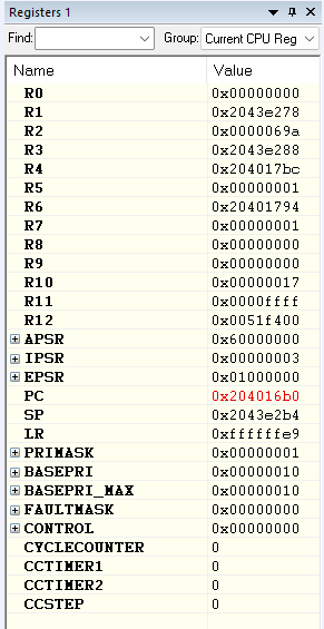

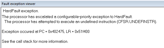

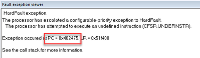

An exception is occurring in the HSE firmware.
The HSE appears to load code into RAM and execute it; however, an exception is raised while the RAM code is running.
Why is this exception occurring, and how should I proceed with debugging?
The attachment contains the register dump and exception details captured at the time of the fault.

It does not seem to be code executed fro SRAM as it reports different PC address. Rather you exception handlers in SRAM
