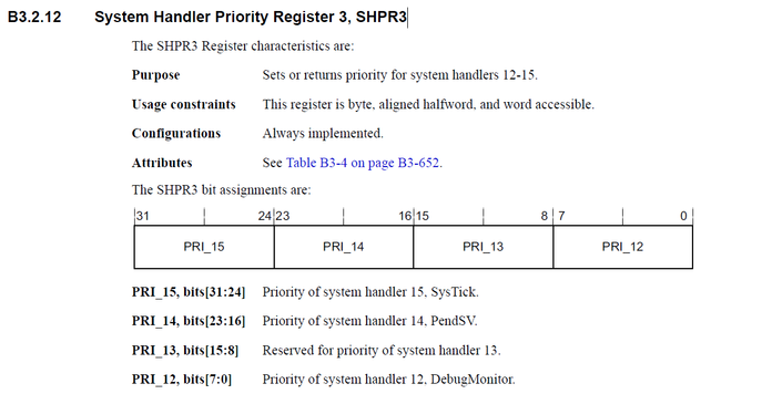

Now I use MCU S32K144, SDK version is 2.9.0.
I have used a DMA interrupt, lpit interrupt and CAN send/receive interrupt.
Now the priority of all interrupt is the default value(0x00);
I wanted to DMA interrupt and lpit interrupt can interrupt CNA CAN send/receive interrupt, So how to configure it? just configure the priority of  DMA interrupt and lpit interrupt is less than the priority of CNA CAN send/receive interrupt?

Hi @asd046012,
The DMA interrupt and the LPIT interrupt must have higher interrupt priorities than the SysTick and the FlexCAN.
For example,
DMA, LPIT: priority number 0 (default)
FlexCAN, SysTick: priority number 1
The Systick priority is configurable in System Handler Priority Register 3, SHPR3.
ARM®v7-M Architecture
Reference Manual
S32_SCB->SHPR3 |= S32_SCB_SHPR3_PRI_15(0x10); // SysTick Priority 1

     There is also an system tick timer interrupt, I also hope that the DMA interrupt and the LPIT interrupt can interrupt the system tick interrupt.
      could this requirement  be achieved?
