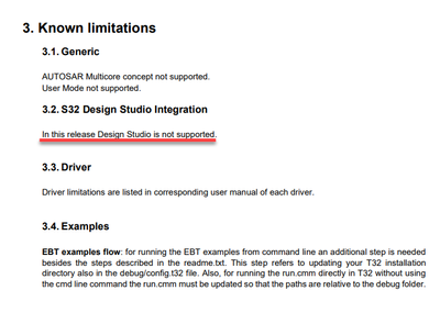

We are working on PMIC(FS26) code on S32K388. For this we are trying to use the Support package "SW32K388_SBC_FS26_R21-11_3.0.0_CD01". We are facing issues with the ways Configuration of this driver happens in code. Could you please help us in how to build this code for testing.
This package uses code configuration from XML and other files. Want to know how to build this code from S32DS.
Anil Patil
1,393 Views
Julián_AragónM
Hi @anilsp31,
The software package SW32K388_SBC_FS26_R21-11_3.0.0_CD01 supports EB Tresos, and does not support S32Ds, as shown in the release notes:

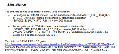

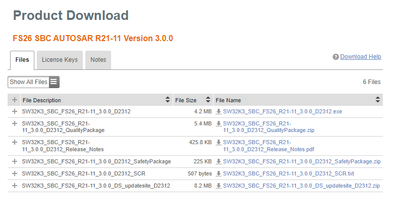

Please search instead for the "FS26 SBC AUTOSAR R21-11 Version 3.0.0" package, as this is the supported software for S32 Design Studio. The Design Studio supported version will come with a UpdateSite.zip file included.
Please follow the installation requirements for RTD version.
 I hope you find this helpful.
