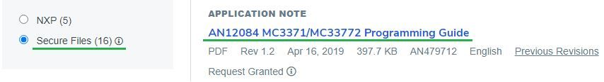

I can received message from a MC33772 using the MC33664 with TPL communication.
For example I know how to send the command "Read 1 to 6 cells voltages"
I get the answer with 6 differents frame, corresponding to the 6 cells voltages :
E3 1F BB 10 75
E3 09 BC 10 70
E3 BA BD 10 FC
E3 0F BE 10 A9
E3 13 BF 10 E8
E3 13 C0 10 57
I would like to know how I can translate this hex values in volt ?
I have the same question with temp values and others response I can get...
I didn't find anything in documentations about this component.
Thanks a lot

Hello Yan,
I would recommend you to take a closer look at our AN12084 (MC33771B/MC33772B Programming Guide) that explains, among others, how to convert raw values from MEAS_xxx registers to real values in Volts, Amps and °C.
The AN12084 can be downloaded rom the MC33772 product website and is classified as a Secure File requiring an NDA
Tomas
