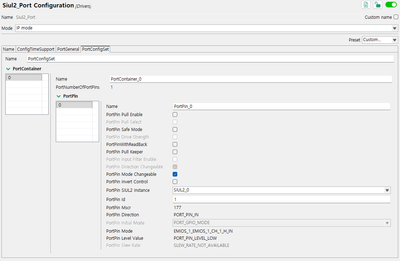

As shown in the figure below, the PTF17 pin is set to the emios_1_ch_1_h input pin.

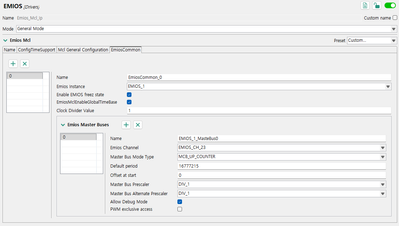

The EmiosCommon setting value in the Mcl component is set as shown in the figure below.

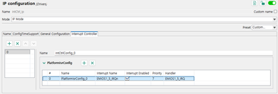

The Interrupt Controller setting value for the IntCtrl component is set as shown in the figure below.
Finally, the PortConfigSet setting value for the Siul2_Port component was set as shown in the figure below.
When I read PWM data using the Emios_Icu_Ip_GetDutyCycleValues ​​function in the main function, it is not working.
