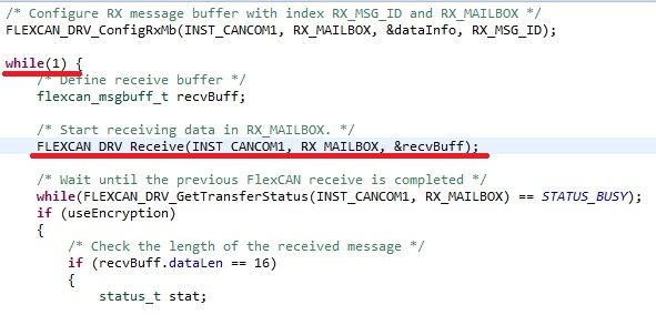

kimjunghyun
Hi. Petr Stancik.
Do you mean this code is interrupt?
* from CAN_SLAVE_Example
Kim
