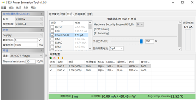

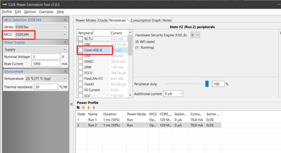

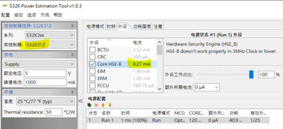

Hi David
Why the s32k312 HSE power consumption higher then s32k344?
s32k312:
s32k344:

These two devices are using different HSE firmware. That's probably the reason.

Pay attention to Power Estimation Tool:
https://www.nxp.com/design/automotive-software-and-tools/s32k-power-estimation-tool-pet:S32K-PET
In this tool you may choose specific configuration according your application use and see estimated power consumption waveforms.
