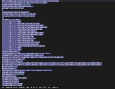

Thank you for your reply, I encountered the following problems when debugging S32K344_Advanced_SecureBoot Project, please help support.
my project test on s32k312.
1.The Secure Boot CFG result is as follows
2. I change to secure boot by setting BOOT_SEQ
but ,my app can not be boot.
