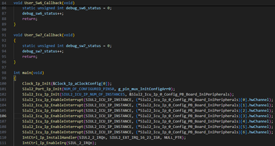

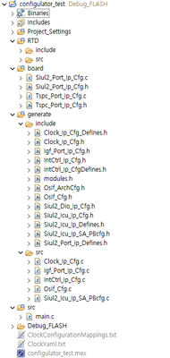

Hello, I am working with the S32K314 MCU and using S32DS version 3.5. In the [06_S32K3xx_Pins_and_Clocks_with_RTD_Training] document, it mentions that when updating the code in the Siul2_Icu Configuration part, the following files should be generated:
However, in my case, these files are not generated as expected. As a result, I am unable to use the parameters referenced in the example.
How can I resolve this issue?

Hi @malove
I am afraid that the most viable option is to unistall the RTD version 3.0.0 from S32DS an install the version 4.0.0. Then generate a new project and then copy the application source files from your pre-existing project as well as any customizations you made to the project properties.

1. I can't find 'Siul2_Icu_Ip_BlinkLed' example in my example from project
2. I am curious about what should be entered as an argument for Siul2_Icu_Ip_EnableInterrupt. The parameters in the photo I attached when asking a question are based on an old version, so what should I replace them with in the current version?

This training presentation was done with an older version of RTD, so there are significant changes in newer versions. In this case, the names of the structures and definitions generated by ConfigTools differ from those mentioned in the presentation, for example:
Use
Siul2_Port_Ip_Init(NUM_OF_CONFIGURED_PINS_PortContainer_0_BOARD_InitPeripherals, g_pin_mux_InitConfigArr_PortContainer_0_BOARD_InitPeripherals);
Instead of
Siul2_Port_Ip_Init(NUM_OF_CONFIGURED_PINS0, g_pin_mux_InitConfigArr0);
I suggest you to check the Siul2_Icu_Ip_BlinkLed example code (provided with the RTDs) for a better reference.
