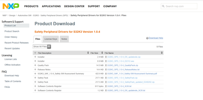

Hi @petervlna ,
Thanks for your quick response. I checked by installing both SPD and SAF separately. Even within SAF, I only see the three components I mentioned earlier. I’m using the S32K358; you can see the setup below for reference[below image].

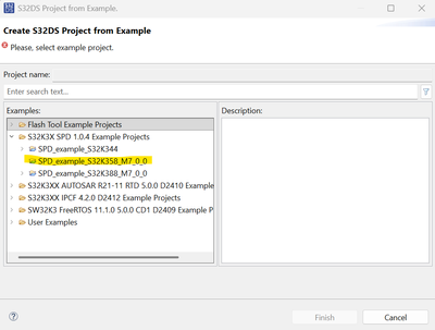

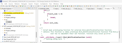

Hi @petervlna ,
Thank you for the clarification. I just wanted to check—are these examples only supported in EB tresos? I noticed that the example shown in the screenshot you shared doesn’t load in S32 Design Studio, which is why I was requesting a demo project. The location you mentioned does seem to contain examples, but they appear to be specific to EB tresos.
Is there any code or reference example similar to the EB tresos one that can be used directly in S32 Design Studio? I haven’t worked with EB tresos before, so I’m not sure if I might be missing something. Alternatively, could this be an installation issue on my end? I’ve installed from the NXP package path below, and I still only see the three options I mentioned earlier.

petervlna
The Demo is for EB tresos.
You can create your own following the tresos example. There is already template for S32DS.
As 95% of customers use tresos, we have not created one for S32DS, at least this info I get from SAF team.
I am not aware for any examples for S32DS available.

PS:
The RTD5 demo I tried (screenshot attached) is not loading properly in S32 Design Studio.
