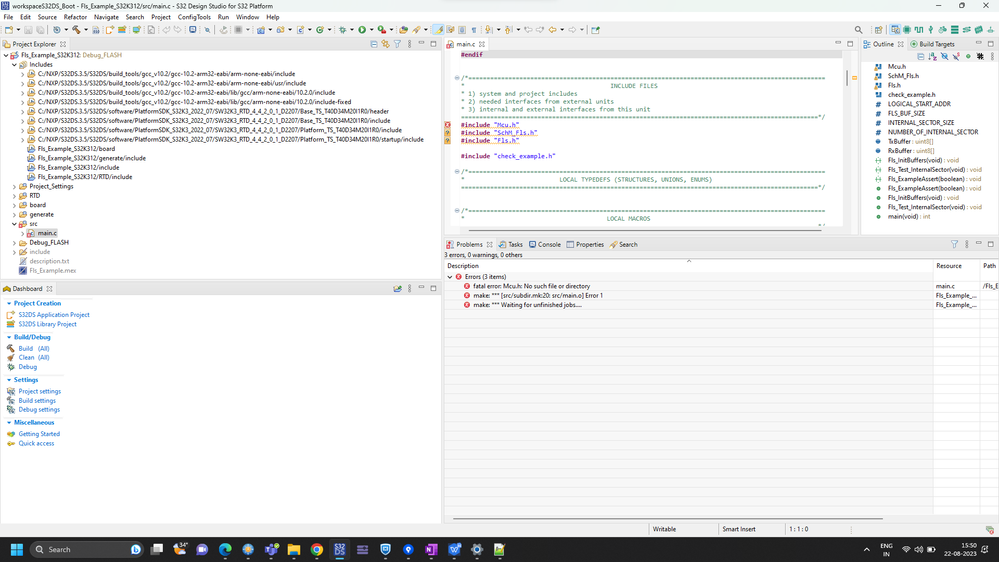

I tried Compiling a sample code for Fls in s32k312 SDK and seems some basic Header files are missing from the Base.
Could someone help me to realize what is missing? Screenshot attached BelowScreenshot 2023-08-22 155039.png

Once you create a new project from an example, generate the code by switching to Peripherals/Pin/Clock tools (Config Tools) and clicking "Update Code".
B.R
