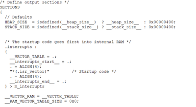

Hi Daniel, quick update on this topic.
I have enabled the FTFC interrupt and put it into the SRAM but I'm still getting the Hardfault exception. ( see the image below)
The HardFault happens when the execute_command function is being executed (
HardFault exception at 0x1FFF8424)

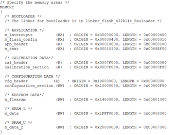

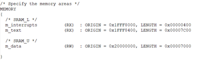

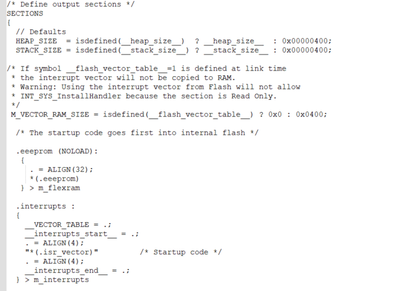

here is my linker configuration:
Flash:
RAM:
Am I missing something in the linker configuration ?
Is it mandatory to enable the FTFC interrupt ?
Alberto
