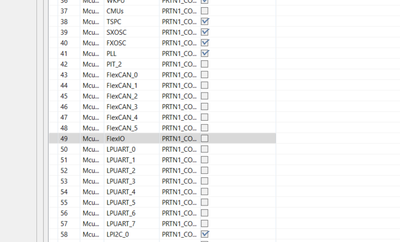

I am facing a problem while configuring the S32K344. Without I2C MCAL configuration, I can go to debug mode. However, when I add I2C MCAL configuration, I got the following error:
MemManage: The processor attempted an instruction fetch from a location that does not permit execution.
while Mcu_InitClock(McuClockSettingConfig_0) was called. Could you please help? I attached the project here.
I'm using S32K3X4EVB

Thanks for your reply,
I already enable the PLL & I2C peripheral clock, but the problem still persist.

Thank you for your patience.
Here is the reply from Software Team:
I checked the example after adding I2C, I see that the section int_sram_no_cacheable was overflowed Because I2C used quite larger spaces in that section.
The solution is that reduces using int_sram_no_cacheable
E.g: in the file ethif_port.c,  you can also remove the statement:  " __attribute__ ((section (".int_sram_no_cacheable")))" as below
VAR_ALIGN(uint8 ethif_DataBuffer[ETH_RXBD_NUM * ETH_43_ETH_MAX_RXBUFFLEN_SUPPORTED], 64);
BTW, Please remove the preprocessor: "D_CACHE_ENABLE" if ping cannot work

Please configure the McuPeripheral -> Peripheral Clock Enable
Hope it helps.
