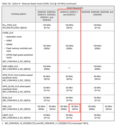

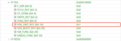

There is a issue that when i download the app file into B block via uds, then use HSE function swap to B block ,i found there are two times HSE_SWT_RST reset interval is 10s after funtional reset.

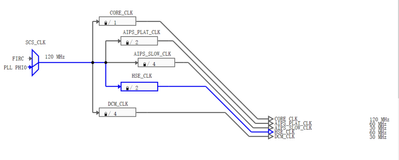

i think my clock is ok as below:
i also check the HSE_CLK_MODE_OPTION is 00b,which means the ratio is 1:2

The HSE_SWT reset could be caused by the missing Power_IP_SetMode configuration. Settings like MODE SETTING and POWER in the MCU module are necessary because, without them, certain clock gating may not be correctly configured. While it is not an error to leave these settings unset if HSE is not being used, some default clock gating may conflict with HSE requirements. As a result, the HSE_SWT reset will be caused by an incorrect clock configuration.
