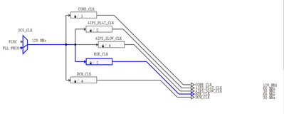

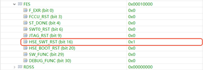

There is a issue that when i download the app file into B block via uds, then use HSE function swap to B block ,i found there are two times HSE_SWT_RST reset interval is 10s after funtional reset.
i think my clock is ok as below:

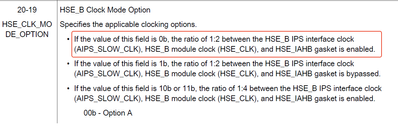

i also check the HSE_CLK_MODE_OPTION is 00b,which means the ratio is 1:2
