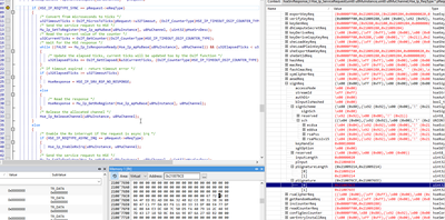

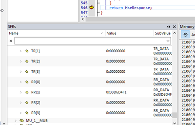

Hello ,
I am getting HSE_SRV_RSP_GENERAL_ERROR when using verify service of HSE.
HSE version being used is 2.40 on S32K311
ECC Public key is stored in NVM. Did not received an error while importing key.
Key is configured for SECP256R1 curve and ECDSA signature algorithm is being used.
I also checked RSA signature verification which is executing successfully.
What could be the possible reason behind general error?
