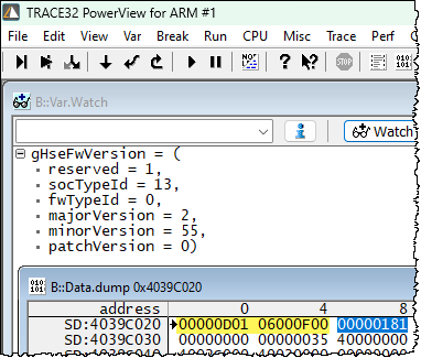

I am trying to perform an HSE FW Update (0.2.6.0 → 0.2.55.0).
Using the HSE_DEMOAPP_S32K312_0_2_55_0 program, I proceeded as follows.
1. Load menu.cmm
2. Load demo app binary
3. Load demo app symbol
4. Run demo tests

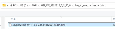

5. HSE FW Update - Update HSE FW - One Shot Mode
6. Select s32k312_hse_fw_1.13.0_2.55.0_pb250129.bin.pink
Afterwards, when reading the version, the output is shown as below.
Has the FW update been performed successfully?
BRs,
Sean Sung

According to the Table 168. SBAF and HSE Firmware version compatibility for S32K312, S32K342, S32K322 and S32K341 devices of RM758225-RM00286 HSE-B Firmware Reference Manual - V2.5(2.5).pdf. It shows Fully Compatible.

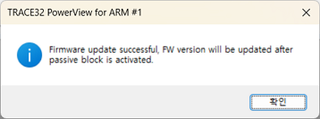

After following the steps in 6.4.3. FULL MEM to AB SWAP HSE FW Update (the steps you mentioned in your question), did you follow 6.4.4. AB SWAP to AB SWAP FW Update, which requires "Activate Passive Block"?
After update finished, I see that gHseFwVersion has been updated to 0.2.55.0 and SBAF has been updated to 0.15.0.
6.4.4. AB SWAP to AB SWAP FW update  gHseFwVersion.png6.4.4. AB SWAP to AB SWAP FW update gHseFwVersion.png

Robin_Shen
Hi Sean Sung,
According to the gHseFwVersion in ssean_4-1758605150886.png, the current HSE FW is S32K312 AB_SWAP 0.2.6.0
Did you follow the steps shown in section 6.4.3. FULL MEM to AB SWAP HSE FW Update of HSE_DEMOAPP_S32K312_0_2_55_0_ReadMe.pdf?
C:\NXP\HSE_DEMOAPP_S32K312_0_2_55_0\HSE_DEMOAPP_S32K312_0_2_55_0_ReadMe.pdf
Robin

ssean
Hello @Robin_Shen
I executed it in the same way as described in section 6.4.3. FULL MEM to AB SWAP HSE FW Update of the HSE_DEMOAPP_S32K312_0_2_55_0_ReadMe.pdf file.
The currently installed version is 0.2.6.0 AB SWAP.
Is it correct that FW update from 0.2.6.0 AB SWAP to 0.2.55.0 AB SWAP is possible?

Robin_Shen
Did you updated the SBAF to 0.15.0 by follow the steps shown in section 6.3. Secure BAF Update of HSE_DEMOAPP_S32K312_0_2_55_0_ReadMe.pdf?
4,340件の閲覧回数
ssean
I did not update the SBAF.
The current SBAF version is as shown below.
Is updating the SBAF 0.15.0 mandatory?

ssean
Dear @Robin_Shen
After executing section 6.4.5 “Activate Passive Block”, the update was completed.
Thank you for support.
