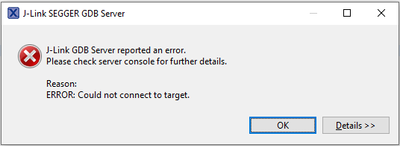

But after that I'm not able to connect controller via SWD, J-Link says it Could not establish a connection to target.
I'm able to erase and program same controller via ISP using Flash magic and it works fine.
ECRP settings are also ok (CRP is disabled). But not able to debug it using J-Link.
This is our second board in which we are facing this same problem. For few days it works fine but after that I'm not able to connect it using J-Link.

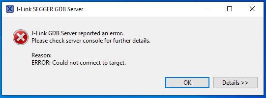

-> No, not able to download other programs using J-Link. I'm also not able to connect controller via SWD/J-Link using J-Flash even after erasing controller using Flash magic (via ISP).

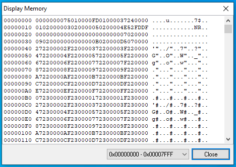

Also after reading device memory using flash magic, data at location 0x20h indicates default configuration of ECRP bits.

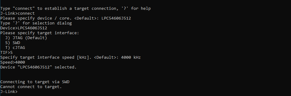

How about use J-link commander to connect your board?
-> Getting same result - Cannot connect to target.

Previously both boards were working fine and I was able to erase, program and debug using SWD for multiple times. But after few days both boards were not able to connect to J-Link.

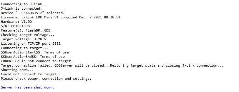

Erase full flash, then debug a simple led project to test.
-> Even after erasing full flash I am not able to debug led project in MCUXpresso.
I've erased flash and then downloaded led code using flash magic but still not able to connect to J-Link.
Previously I was using one board which was working well until I've downloaded EEPROM code. Then that board didn't connected to J-Link yet.
I've tried connecting it using different tools like J-Flash, J-Flash Lite, J-Link Commander but failed.

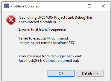

3. Interval 01:05 - Resetting unit, Entering into ISP mode, reading device signature (to check device is in ISP mode).
Then connecting to J-Link (debugging project) but getting error as Could not connect to target.
4. Interval 01:45 - Resetting unit, Entering into ISP mode and erasing flash.
Then connecting to J-Link (debugging project) but still getting same error as Could not connect to target.
