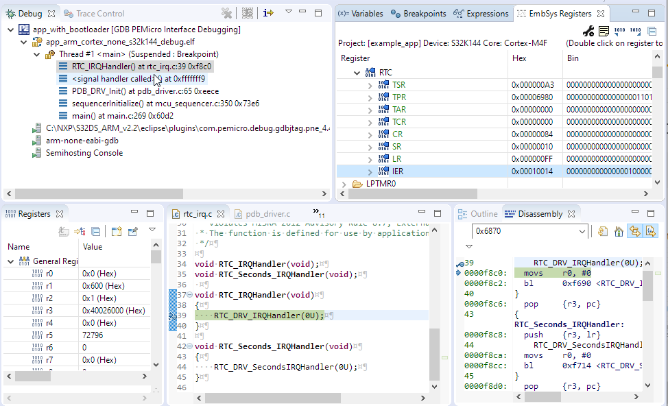

Hello.
I am using my custom bootloader with APP (with position independent code) on s32k144 and I am facing a problem right after app launch (when all clocks are configured and some periphery are inited). MCU permanently runs into this RTC interrupt with no reason (see RTC SR register) and main program halts on same address. I am running into this interrupt even if it is disabled in NVICISER1 (14 bit, according to interrupt map) and when RTC was not inited at all (after every reflashing I am disabling power to reset RTC registers). When I am using step-by-steb debug in main program - all works as it should. I am not sure that this is RTC issue, but how can I check this?
Content of other registers in interrupt, maybe it can help:
NVIC
NVICISER0: 0x0001FFFF @e000e100
NVICISER1: 0x00000000 @e000e104
NVICISER2: 0x0167C000 @e000e108
NVICISER3: 0x04005000 @e000e10c
NVICICER0: 0x0001FFFF @e000e180
NVICICER1: 0x00000000 @e000e184
NVICICER2: 0x0167C000 @e000e188
NVICICER3: 0x04005000 @e000e18c
NVICISPR0: 0x00000000 @e000e200
NVICISPR1: 0x00004000 @e000e204
NVICISPR2: 0x00000000 @e000e208
NVICISPR3: 0x00000000 @e000e20c
NVICICPR0: 0x00000000 @e000e280
NVICICPR1: 0x00004000 @e000e284
NVICICPR2: 0x00000000 @e000e288
NVICICPR3: 0x00000000 @e000e28c
NVICIABR0: 0x00000000 @e000e300
NVICIABR1: 0x00000000 @e000e304
NVICIABR2: 0x00000000 @e000e308
NVICIABR3: 0x00004000 @e000e30c
SCB
ICSR: 0x0040087E @e000ed04
   ICSR->VECTACTIVE 0x07E - reserved of CAN2?

At first, could you try to disable interrupts and move the vector table before the jump to the app?
/* Relocate vector table */
S32_SCB->VTOR = (uint32_t)APP_START_ADDRESS;
I recommend jumping into the application after reset.
I hope it helps.
