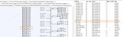

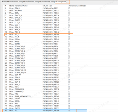

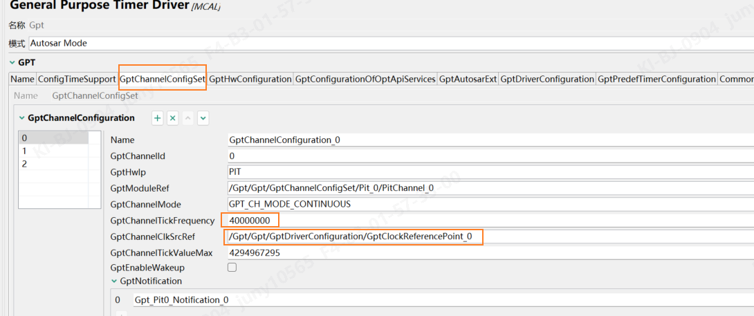

I config the gpt, the gpt clock is 40M. the clock is set as follow:
the mcu clock  show as follow:
and  i start the gpt(Gpt_StartTimer(GptConf_GptChannelConfiguration_GptChannelConfiguration_0, 10000000U);),   I measure GPT time ,it is 200ms。
but i think the gpt time should be 250ms((1/40000000)   * 10000000 = 250ms).

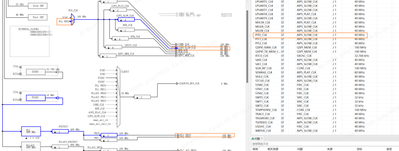

How to confirm that the clock source currently being used is an external crystal oscillator(16M)? Currently, the GPT clock is not 40M, it seems 50M.
