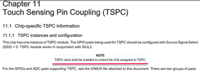

Good news : I managed to drive the pin in GPIO mode. In fact, the TSPC was not clocked. When it is clocked, the pin can be driven. So there is a kind of dependency between TSPC and some GPIO pins.
10,422件の閲覧回数
PetrS
good point...IOMUX excel file shows MCU port and TSPC assignment in "TSPC Selection" tab, and
the RM points to have TSPC clock enabled...
Seems I overlooked that. But TSPC clock should be enabled upon reset, that's why Radek was able to control pin after main function was hit.

dduminy
Hello NXP Guys,
I think that the note is wrongly placed. Indeed, we didn't implement the TSPC feature, only the SIUL2. So I think moving (or copying) this note from TSPC chapter to SIUL2 chapter will help other customers.

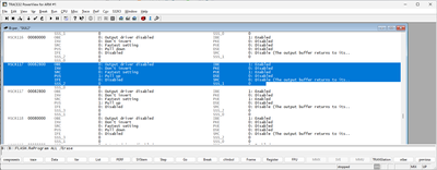

10,673件の閲覧回数

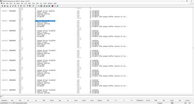

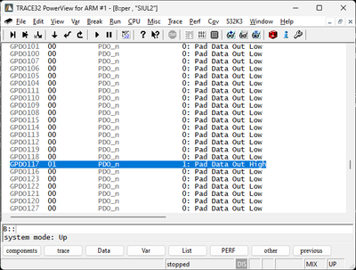

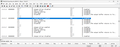

sobo
Hi @PetrS
we have check the register all is OK, but on the pin we can't read a '1', level high.
see attached screenshot.

PetrS
this looks correct, not sure why you do not see it on the pin/header. So assuming you really measure right pin, I can only recommend to do below checks...
- set OBE and IBE with SSS=0, change GPDO and measure pin ouput and GPDI register
- set only IBE, and enable internal weak pull/down, see GPDI. connect pin externally to high/low, see GPDI
- set pin for available peripheral, i.e. eMIOS and generate some output, can be eMIOS GPIO output mode
BR, Petr

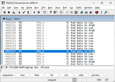

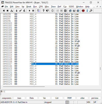

dduminy
When I apply a high level on the PIN GPD21 set as an input with pull down, I can see that GPDI117 is read as high level.
When I apply a low level level on the PIN GPD21 set as an input with pull down, I can see that GPDI117 is read as low level.
When I apply a low level level on the PIN GPD21 set as an input with pull up, I can see that GPDI117 is read as low level.
When I apply a high level level on the PIN GPD21 set as an input with pull up, I can see that GPDI117 is read as high level.
So, the GPD21 behaves correctly when it is used as input

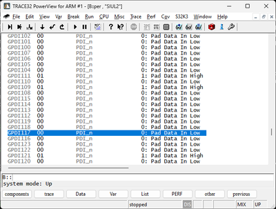

dduminy
Here are the screenshots of the 3rd test :
The level of GPD21 pin is low (0V)

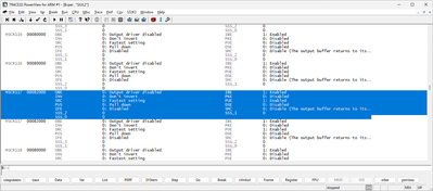

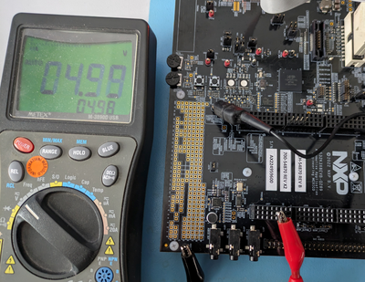

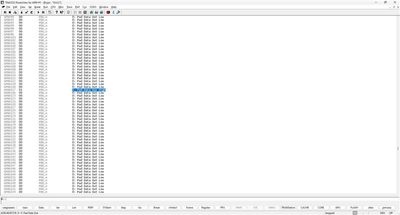

10,622件の閲覧回数
dduminy
Here are the screenshots of the 2nd test :
The GPD21 pin is in high state (around 5V)

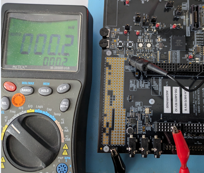

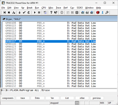

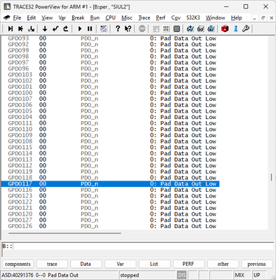

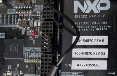

dduminy
Hello Petr,
I works with Sophie. Here are the screenshot of the first test
The PTD21 remains in low state (0V)
10,580件の閲覧回数

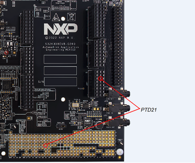

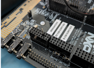

RadekS
Hello dduminy,
That is very strange.
We tried the same test on the same setup (S32K3X8EVB-Q289, the same MCU maskset, and the same manufacturing batch).
We restart MCU and wait at the breakpoint at the beginning of the main() and drive the pin directly by Lauterbach probe. We measured voltage at PTD21 pin at J357 connector and also on GPIO pin matrix breakboard.
The output voltage fits with the pin output level and the same levels was detected at the pin input.
RadekS_2-1709296472730.pngRadekS_2-1709296472730.pngRadekS_3-1709296503067.pngRadekS_3-1709296503067.png
Are you sure that you do not have any load/short externally connected to the PTD21?
