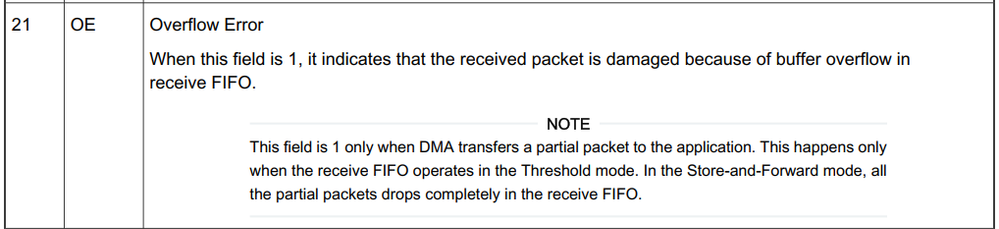

Second, I didn't see bit OVERFLOW raised in your case and as description from RM:
So, bit OE just indicates the buffer doesn't have enough space to store entire frame and the frame will be damaged. I don't think that we need to handle with overflow here.

2. The overflow bit wasn't shown in the examples I sent but from testing I was able to discover that overflow errors will result in similar bugs with the timestamp. In the example above, I had 5 ring descriptors which was why under high load, the last descriptor would always be a partial write (only buffer, timestamp in MTL queue). I also tested with 4 ring descriptors which in theory should never hit the same bug, since it will only always hold 2 buffer-timestamp pairs. However, I noticed that even for 4 ring descriptors, I would get an overflow error, which would take up one ring descriptor leading us to have effectively 3 ring descriptors, in which case we would hit the same bug as before because of odd number of ring descriptor.
