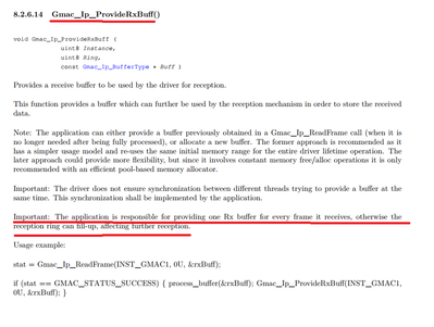

Nhi_Nguyen
Hi @oliver777777 ,
I missed the note in UM about the sequence of receiving frame:
So, the issue can't occur if you call Gmac_Ip_ProvideRxBuff after each Gmac_Ip_ReadFrame();
Please let me know if you have any response about this.
