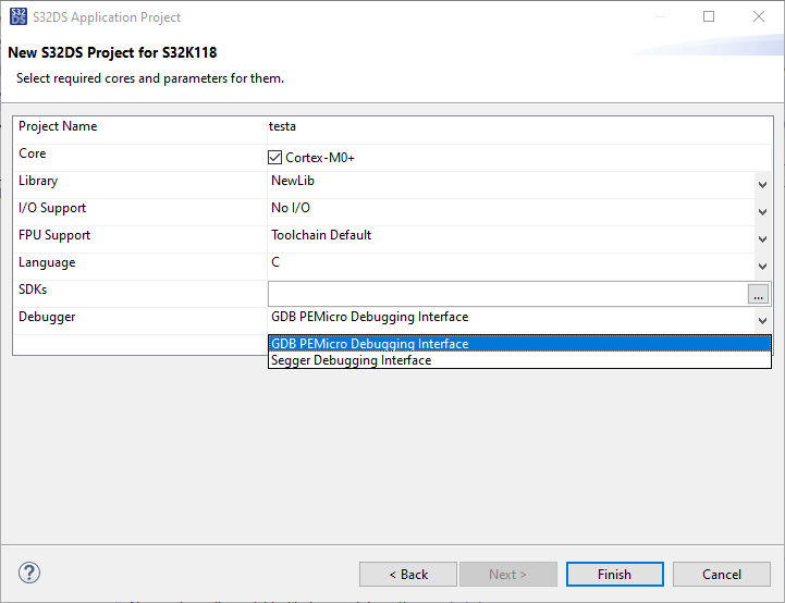

I am using S32DS for platform with S32K118 EVB. I have installed GDM PEMicro debugging interface and trying to use the Open SDA USB for connection.
But the PEMicro interface is not listed in the tool chain.
For flashing an application to the board, how do I select the tool?
I tried S32DS for ARM2.2 to build a program and the PEMicro tool was available n it. I tried copying the srec file)of an available project) to the EVB drive, and the Green LED near to the SDA USB port started blinking. But the same was not possible with S32DS for platforms as the tool was not listed. Is it not supported?
Does it have anything to do with the system I am using (Windows 10)?
Please advise.
Screenshots attached for reference.

Have you select the "GDB PEMicro Debugging Interface" when create new project?

Hello Robin,
Yes I did select the option while creating the project.

How do you installed GDM PEMicro debugging interface? The version of GNU ARM PEMicro Interface Debugging Support on my S32DS3.4 was 5.1.4. But you are showing version 5.1.7.

Have you tried uninstall the S32DS and install it again?
