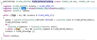

I tried to write a function that performs FLASH memory programming using the Express interface that area described in the "21.5.1.4 Express program" of the S32K3xx Reference Manual, Rev. 9, 07/2024  not supported by the current RTD.
The file with the source code is attached.
Unfortunately the writing fails randomly for Functional Reset of SWT_0.
The function is executed in ITCM.
Can someone help me understand where I went wrong in the sequence of the operation?

Hi @enricoantonioli,
The drivers come without any support, we don't have any example where FLASH_WrOnceCrashLog() would be used. I shared it just for a reference. And there seems to be no difference between the driver and you code.
The execution is time is not specified.
You can measure the execution time yourself in your setup and then adjust the SWT_0 timeout.

I don't see any possible root cause.
Have a look at the attached project.
In \src\drivers\flash\flash.c, there is FLASH_WrOnceCrashLog().
Also, make sure the system clock configuration matches one of the clock options precisely.
RM rev9, Sectio 24.7.2 System clocking configurations

Hi Daniel,
thank you for your reply.
The clock settings I am using are below:
  • PLL_PHI0_CLK=120MHz
  • CORE_CLK=PLL_PHI0_CLK/1=120MHz
  • AIPS_PLAT_CLK=PLL_PHI0_CLK/2=60MHz
  • AIPS_SLOW_CLK=PLL_PHI0_CLK/4=30MHz
  • HSE_CLK=PLL_PHI0_CLK/2=60MHz
  • DCM_CLK=PLL_PHI0_CLK/4=30MHz
At the power on, executing code from RAM, I set RWSC = 3 on CTL (Module Control) register, in accordance with what is described in the data sheet "9.5 Flash memory read timing parameters" for S32K311.
The C code depicted in the function that you suggest me, I the same of mine code.
Have you ever tried the function FLASH_WrOnceCrashLog()?
The source C code of the function FLASH_WrOnceCrashLog() I the same of mine code.
I would like a clarification, I don't understand how to call the FLASH_WrOnceCrashLog() function and what should the logs array variable contain?
Could you suggest me an example of using this function, even inside a simple main() function, please?
The datasheet does not report writing times using the express interface. Is there any way faster express writing is than main?
