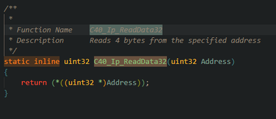

As I stated above, from what I can see from the source code of the MCALs, there are functions that are not declared by using the compiler abstraction macros like INLINE or LOCAL_INLINE, for example:
since they don't use the INLINE or LOCAL_INLINE macros, I cannot use my Compiler.h abstractions.

Let me ask the SW team about this issue. But it seems like the snippets you are referring are based on the non-AUTOSAR (IP) layer, which I believe is not constraint by SWS and often uses static inline for performance and portability across compilers.
I will get back with you as soon as I get an answer.

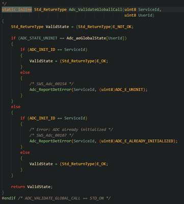

I understand that, but you can also find snippets of code that are missing the usage of AUTOSAR keywords in the main module sources; here is just an example for the Adc.c file:
I understand your point, but please consider also our point of view: in the case you described we would not be able to use the benefits of the inlining and this could cause potential performance issues.
Aldo
