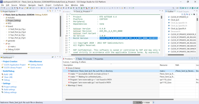

I'm using S32D3.4 and RTD version 2.0.0(S32K3_RTD_2_0_0_D2203_ASR_REL_4_4_REV_0000_20220331), I just create new project based on example based on Flexio_Sent_Ip_Receiver_S32K344. But I got errors:
fatal error: Flexio_Sent_Ip.h: No such file or directory
1,479 Views
Li_Chen
It seems I have to double click the mex file and click "Update Code" button
