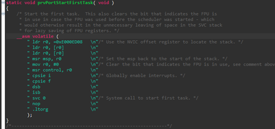

I am running a project in which I use FreeRTOS and a few drivers. Nothing too fancy. I'm using the SEGEGR J-Link debugger, and I kept running into this problem at startup.
I thought it was my code, so I decided to go ahead and use the blinky example provided by NXP. No modifications no nothing. Same error.
Does anyone have any idea why this happens?
Thank you!

Hi Mateo,
do you mean this example?
c:\NXP\S32DS.3.4\S32DS\software\PlatformSDK_S32K3_2021_10\FreeRTOS\examples\S32DS\FreeRTOS_Toggle_Led_Example_S32K344\
I just tested this one on my board with Multilink FX and it works as expected on my side...

I have the same issue on the same example and I have FreeRTOS for S32K3 2.0.1.
Can someone explain what is the root cause of this?

Hello, yes it's that example. I tried to re install the FreeRTOS extension and it works correctly now. Thank you!

What do you mean by "re installed the FreeRTOS extension"?
I'm facing the same issue.

Update to version 2.0 of the drivers as well as FreeRTOS.
This will resolve all these problems.
Also, if you have a Jlink debugger, try downgrading to a lower version of the Jlink firmware.
In our experience, the PNE micro debugger has always worked with no issues, but we've run into quite a few issues with JLink. Most dev kits will have a PNE micro debugger
