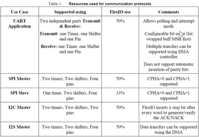

The description in the flexio specification can be mapped to many interfaces, such as SPI, IIC, UART, etc. My question is: can flexio define any interface? For example, flexio has 8 bits. Can you use 2 SPIs or 4 UARTS?
1,253 Views
Senlent
Hi@chenjun0290056
you can refer to AN12174 to know more about FlexIO.
AN12174 LINK
