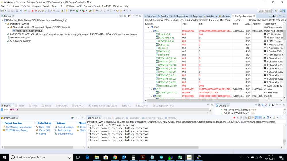

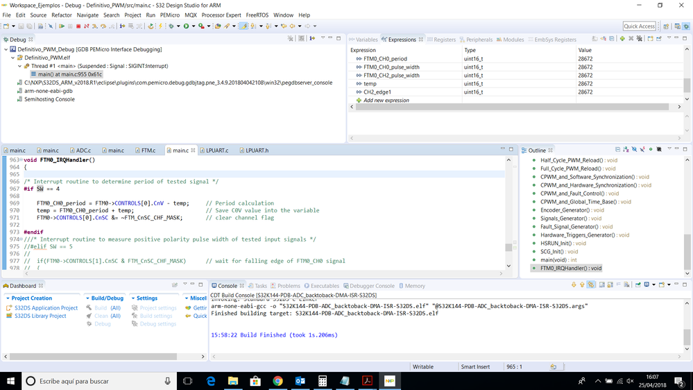

Hi to the community,
I am running the example (#define SW 4) of the Single Edge Capture, but all the variables have the same result. Even those which are not being used. What could be the problem here?
I attach the code below.
Jorge

danielmartynek
I slightly modified the code.
/* Interrupt routine to determine period of tested signal */
void FTM0_Ch0_Ch1_IRQHandler(void)
  period[counter] = FTM0->CONTROLS[0].CnV - temp;
  temp = FTM0->CONTROLS[0].CnV;
  FTM0->CONTROLS[0].CnSC &= ~FTM_CnSC_CHF_MASK; // clear channel flag
  counter++;
  if((counter) == 20){
    FTM1->SC = 0;
The results:
Since
FTM1->MOD = FTM_MOD_MOD(11200 - 1); // Set Modulo (10kHz PWM frequency @112MHz system clock)‍
the result seems to be correct.

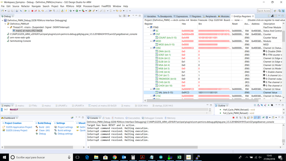

I'm unable to compile the attached project for some reason.
Does the interrupt trigger?
What is the value of FTM0->CONTROLS[0].CnSC in the register view?

electronica2pow
I created a new project in order to allow you to compile it. I attached it below.
Yes, it is triggering and the counter is working ok, but i don't know why i can't get the results.
