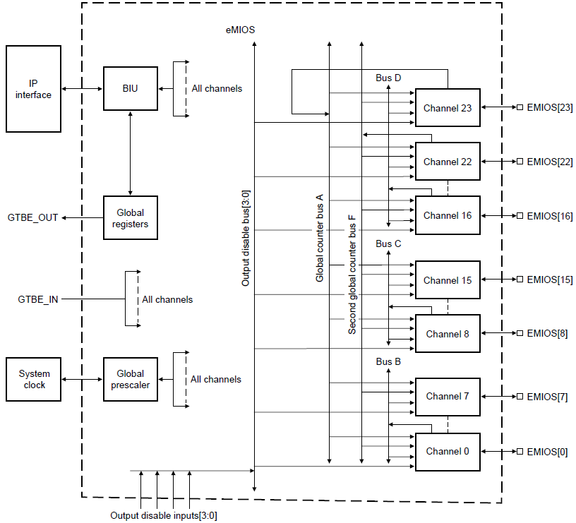

Hello all,
I would like to know if there is a way to trigger or to synchronize Emios channels and FlexPWM channels at the same time ? I try to use TRGMUX in vain.
Thank you.
931 Views
Senlent
Hi@Silvano
I think your question here refers to how the emios module achieves its output PWM synchronization.
In fact, if the selected PWM channels use the same Global Counter, output synchronization can be achieved.
For example, all PWM output channels under emios0 use Global Counter Bus A.
