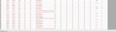

Hello All,
I am using FLexIO for PWM geneartion and everything is mostly working properly and i am faing error in Transmission as you can see i am using 2 timer for SENT. TImer0 is working properly with no or less red data but for timer 1 its too much red data(if data is different) if i transmit same data then both are smae with less error.

Hello @JustMet,
Sorry for the delay, I have been busy.
I see a few issues in the code.
1. You should have a separate state machine for each of the channels in the ISR, not just one for both.
2. Also, you don't poll and clear the second flag.
3. Don't use read-modify-write (|= operation) to clear the flags. These are W1C bits, you have to use a direct write just to the flag you want to clear.
BR, Daniel
