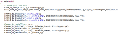

I am trying to send a message from FlexCAN0 MB to FlexCAN1 MB. But the message is not loading in the message buffer of FlexCAN1. I have attached the project.
I am using S32K3X4EVB-T172 board.

I have not tested your project, but the issue could be that you are installing the same handler for both CAN0 and CAN1 in your main code:
It seems CAN1 IRQ Handler is not declared.
