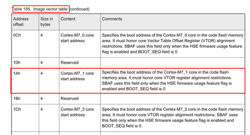

I have a custom designed standalone NXP S32k322. I have been using it for the past 2-3 weeks. I am using Segger J-Link Edu Mini flasher along with J-Flash Lite software to flash the controller. I have been flashing the program using the probe successfully for the last 2-3 weeks and the code was working fine on it. Now, my programs are getting flashed just fine, but the programs aren't executing as they were supposed to. I'm attaching an image for your reference.
Alos, in the image is my core 1 address correct?
I even tried flashing the programs that were working earlier but with no luck.
Any help is appreciated.

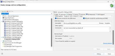

I had already done the modifications and I was able to blink the LEDs using the timer. For unknown reasons, it stopped working when I erased the flash and retried to flash the code.
Can you at least guide me in the direction of how to debug using the J-Link Edu Mini probe?
In the debug configuration, I'm getting the following error
Error while launching command: arm-none-eabi-gdb --version
Pratik
