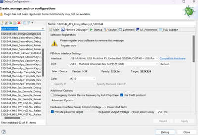

We are using the s32k324 board.
An error occurred while debugging the board and laptop.
We need to build and debug the code.

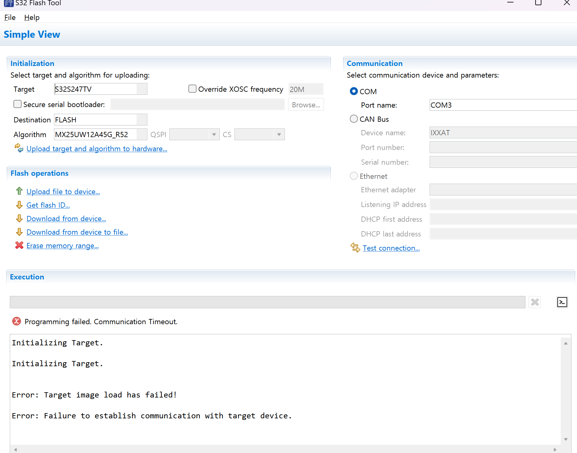

And while using the s32 flash tool, the target device does not have the s32k324 board set up. I read the user guide and it says to download the tool to use the additional device, what should I download?

The file is now in version 344, but the same error occurs when I make the file again in version 324. Is it because the debugger version is low? I wonder if there is a solution.

Hi @minjaekang99
Sorry if I did not explain myself clearly.
A project created for a S32K344 will not work for a S32K324. You need to create a new application project with the corresponding MCU and then copy the application source files from your pre-existing project as well as any customizations you made to the project properties.

Hi @minjaekang99
Since the project was created for a S32K344 device, it will cause faults if used on a different device. The most viable option is to generate a new project with the corresponding MCU and then copy the application source files from your pre-existing project as well as any customizations you made to the project properties.
As for the S32 Flash Tool, it does not support S32K devices.
