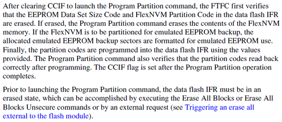

A1.
Please see the description below
In other words, If the MCU has not been partitioned yet, the flash IFR is erased by default and FlexNVM is erased by the Program partition command anyway.
But if it has been already partitioned, you need to Mass erase the MCU before it can be partitioned again.

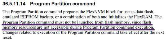

A5.
The FTFC Program Partition command must be launched from flash memory.
The function that launches the command can be in SRAM or it can be done by the programmer.
