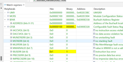

I am currently working on enabling the flash memory safety mechanism (SM1.FLASH.AI_SELFCHECK) and have a few questions regarding the implementation.
I found two relevant APIs in the c40_ip driver: C40_Ip_ArrayIntegrityCheck and Fls_IPW_CheckUserTestStatus.
1. If C40_Ip_ArrayIntegrityCheck starts the flash integrity test and returns the test status (true or false), what is the specific purpose of the Fls_IPW_CheckUserTestStatus API?
2. I understand that the code needs to be copied from flash to SRAM before running the flash integrity test. Could you please provide guidance on how to implement this? What specific changes are required in the linker script?
3. In the latest AUTOSAR standard, the mem40_Infls module is used. Previous AUTOSAR versions included the fls module, which provided configuration options for a user test mode. How can the user test functionality be achieved using the latest AUTOSAR version?

sandeepSingh18606
Hi Daniel,
Thank you very much for your support. There was an issue with my linker script, which I have now updated. Everything is working correctly on my end.
The above example I have accepted as solution is working for me including running example code from SRAM.
Sandeep Singh

4,218件の閲覧回数
sandeepSingh18606
Hi Daniel,
Thank you for providing the example code.
I have tested the code, and while it occasionally works, it is mostly entering the bus fault handler. After checking the CPU registers, the CFSR indicates an instruction bit error.
I suspect the code needs to be moved to SRAM before starting the Array Integrity Check.
Could you please advise on the correct procedure for implementing this?
Sandeep Singh
3,896件の閲覧回数
danielmartynek
Hi @sandeepSingh18606,
I'm sorry for the delayed response — I am currently out of the office.
You are correct; it should run from SRAM.
I haven't found any flash-based example that includes the integrity check running from SRAM. I also contacted the owner of the C40_Ip driver to ask how this was validated, and the answer was that the entire test project was executed from SRAM.
You can place C40_Ip_ArrayIntegrityCheck(), C40_Ip_CheckUserTestStatus(), and your wrapper function in SRAM, similar to how it is done in the following example. At the moment, I'm not fully sure if there are additional functions that also need to be moved to SRAM.
https://community.nxp.com/t5/S32K-Knowledge-Base/S32K312-C40-Ip-SRAM-RTD-500-DS35/ta-p/2074245
