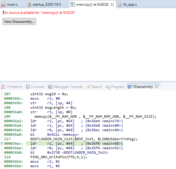

I am working on LIN Bootloader. When we flash the software we need to erase memory .

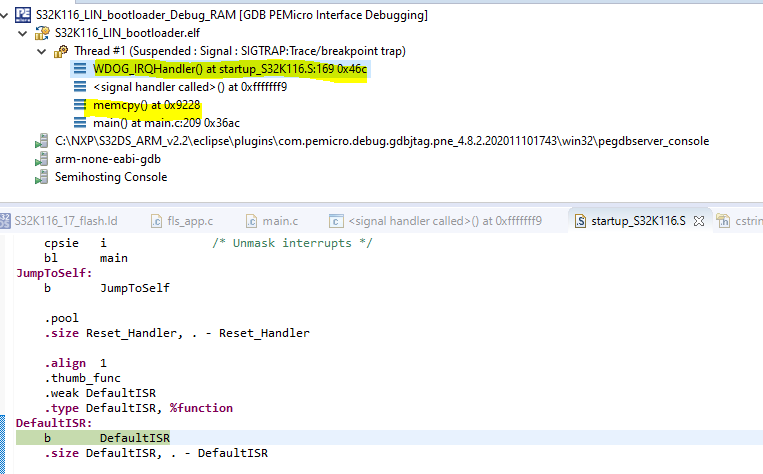

I was requesting erase memory it going to WDT IRQ Handler

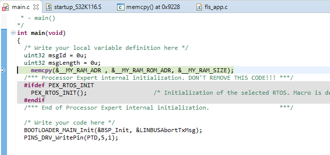

we are using memcopy from there only we are getting issue

this would require more details and more debugging. Can I see the failing code? Where does it crash exactly? What you are copying by memcpy?

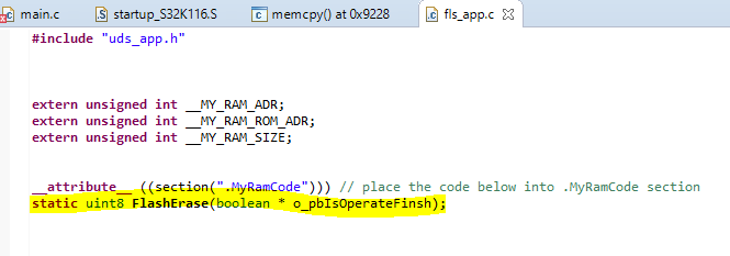

We are using unified_bootloader_framework  for S32K bootloader code using S32K116.we are add Flash function in MyRamcode
can you please check Memcopy
Here crashing the code
