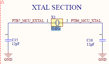

PetrS
how is your connection done?
If using own board, what is crystal used (if selected as PE clock source) and CAN circuitry
Share scope measurement of CAN TX/RX/bus line.
BR, Petr
17,199件の閲覧回数
AparnaSridharan
This is the crystal oscillator circuit we are using in our microcontroller.
Let me know if any other details required to fix issue regarding information transmission and reception through CAN bus.

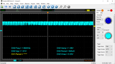

AparnaSridharan
In our customized board we are using 8Mhz crystal frequency.
Also PE clock is enabled. I have attached the clock configuration code below.
Also I have attached the Scope of both CAN tx and CAN RX below.
AparnaSridharan_3-1647250123724.pngAparnaSridharan_3-1647250123724.pngAparnaSridharan_4-1647250131443.pngAparnaSridharan_4-1647250131443.png
17,196件の閲覧回数
AparnaSridharan
hi,
We can realize the CAN signals for the working code.
But for the Fota_gateway program I am not getting any can tx/rx signal. What might went wrong ? Kindly help to fix this issue
