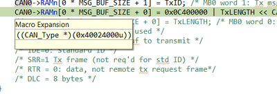

I am currently working on CAN part of Bootloader program to flash application program into MCU (s32k144) memory automatically once update is received. Actually I am using OTA_s32k144_use_case_ws file for this. We have connected the Vehicle Spy on the CAN Bus to understand the CAN Communication. But we are not getting the data on the CAN bus. It's getting stuck in the FlexCAN0_transmit while loop.
while(0 == ( (CAN0->IFLAG1 >> CAN_TXbuffer_ptr->MB) & 1 ));
 Could you let us know why it is getting stuck in the while Loop. What might be wrong ?. While debugging I observed that the code stuck at the line 234, Flexcan of gateway program.
I am using S32ds for ARM 2.2  development environment.
We are testing this on our custom hardware with the same pinout used in the s32k144 evkb PTE4 & 5 for CAN TX / RX.

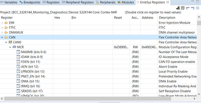

I am not able to view the register mapping details when hover over the register name in my working code. I am able to see only macro expansion. I am not able to see its values.
Also I tried to view through EmbSys registers but hex value of register is not there.
Whether any settings need to be changed for this so that I can view the register values?

AparnaSridharan
Hi Petr,
Kindly let us know how to share the hex Value.
Yes MB Content shows 0. But Where to check for the TX MB Code.

you should double click on register to see its value, I think
For MB0 content display RAMn0-RAMn3 registers.
Clocks validity can be seen from SCG registers (like SOSCCSR, FIRCCSR, ...).

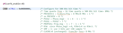

I would suggest to check CAN bit timing setting, if it is a same on both nodes.

 I am configuring CAN 2.0 communication system. Can you suggest CAN bit timing specific to CAN 2.0. Or else any other resource related to that.
17,293 Views
PetrS
there is no specific CAN bit timing, this is set by user, could be 500kbps.

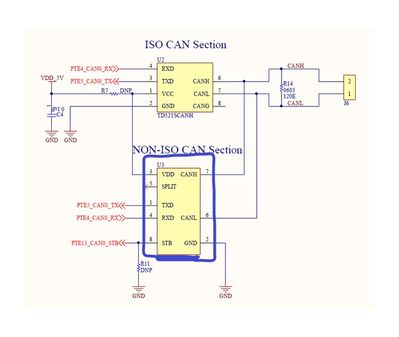

PetrS
how is your connection done?
If using own board, what is crystal used (if selected as PE clock source) and CAN circuitry
Share scope measurement of CAN TX/RX/bus line.

This is the crystal oscillator circuit we are using in our microcontroller.
Let me know if any other details required to fix issue regarding information transmission and reception through CAN bus.

AparnaSridharan
hi,
We are using NON ISO part of above schematic in our board. Let me know if any other information need to be shared.

PetrS
is the R7 really DNP and so transceivers do not powered, I guess no.
How is the STB driven? BTW what kind of transceiver is it?
BR, Petr
17,190 Views
AparnaSridharan
R7 is connected. MCP2561-E/SN is the transceiver we are using in our board. Also the STB is always pulled LOW.

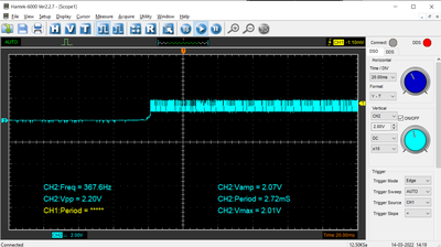

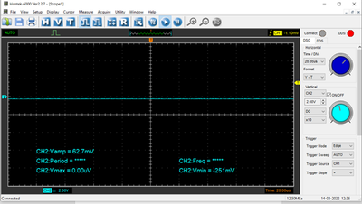

then, assume transceiver is really in normal mode, then if connected to CAN bus and other node is sending a message, you have to see this message on RX pin and MCU should send ACK low pulse on TX line. Is this your case?
Also if transceiver is terminated and disconnected from bus/other nodes, and MCU is sending a message you have to see it on TX/RX lines, if not most probably pin are not properly configured.
You can also test pin setting by disconnecting transceiver and connecting TX/RX together, then send a message. You have to see message transmitted still.

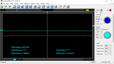

AparnaSridharan
In our customized board we are using 8Mhz crystal frequency.
Also PE clock is enabled. I have attached the clock configuration code below.
Also I have attached the Scope of both CAN tx and CAN RX below.
AparnaSridharan_3-1647250123724.pngAparnaSridharan_3-1647250123724.pngAparnaSridharan_4-1647250131443.pngAparnaSridharan_4-1647250131443.png
17,207 Views
AparnaSridharan
hi,
We can realize the CAN signals for the working code.
But for the Fota_gateway program I am not getting any can tx/rx signal. What might went wrong ? Kindly help to fix this issue
