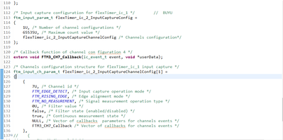

i porting my corrert software to anothoer hardware .
the capture moudle was worked on the original hardware,but it used FTM3_Ch4.
i change the channl to FTM3_Ch7 on the new hardware , and it just cannot work cause the callback function has failed. Program will not pause even i play a breakpoint in the callback function.
the configuration arr as  follows(i have implement the callback function):
is there something that i have forgot to changed?

please check:
1. Whether the interrupt is enabled and whether the interrupt number is correct
2. Whether the configuration of the PIN foot has been modified

wutengyouxi555
sorry I was on a business trip last week
The pins are already configured correctly
There is no problem with interruptions eitherk
i check the program again , the problem maybe:
i configure FTM3-6 as PWM output , and configure FTM3_7 as input capture. The configuration that follows covers the configuration that comes before.
Could one FTM be configured in two modes? And how to do.

Senlent
Hi@wutengyouxi555
Sorry, it does not support the same FTM instance to be configured as PWM or ICU at the same time.
